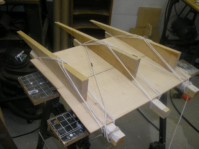

There is no secret to this method, it just uses the wedge to tighten up the rope.
Also the dimensions of the slats and wedges are not critical. I think as long as the wedge is wide enough, 1" or better and the slate about the same or slightly more, you'll have no problems. For my slats, I just used what ever scrap 2x2 I had lying around and the wedges I made out of scrap fir, 4" x 18" cut on the diagonal gives me two of them.
Of course, like all joining methods, you need to have the plates candled well to have a good join.

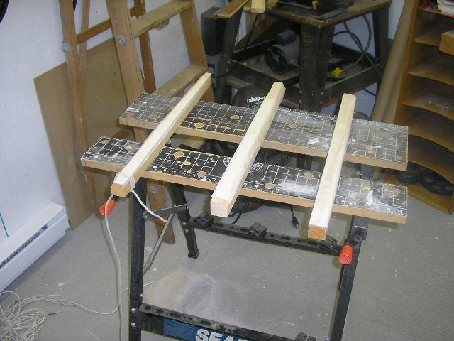

I have mocked up some pics to try and help out.

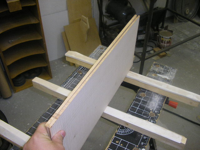

Start with the slats on a workmate or some other surface that will allow you to get at each end of the slat.
Tie one end of your rope to one end of one of the slats.

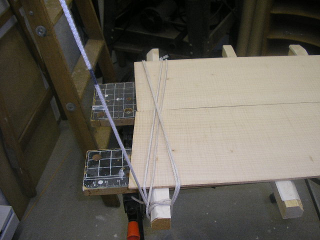

Now run a bead of glue down the middle of the plates to be joined, and run your finger along the seam to spread the glue.

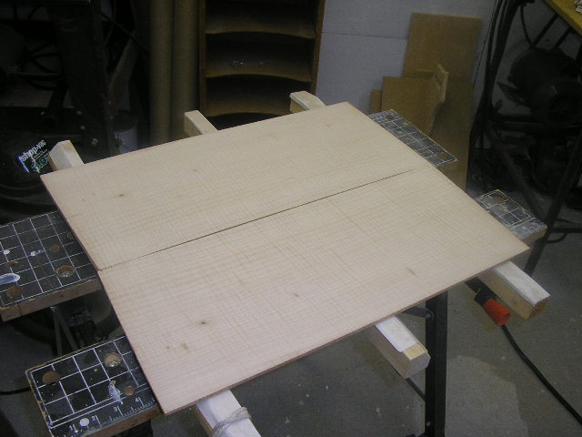

Now open up the plates and set them on the slats.

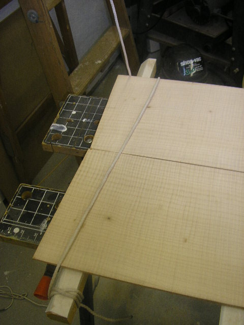

Now start to criss cross the rope over the plate like so,

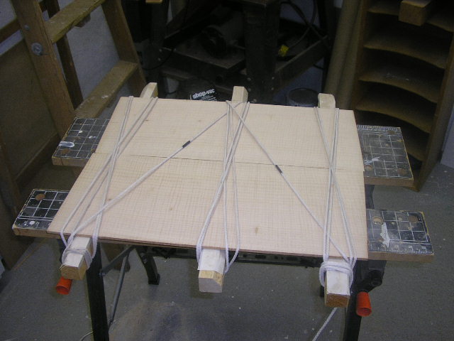

Move your way along the plate and the slats, criss crossing about two times per slat.
Now, be sure to pull the rope tight to the edge of the plate and around each slat end, than push the wedges into place (YOU DON'T NEED A MALLET, JUST YOUR HAND WILL DO). Watch the glue squeeze out of the joint and you don't need much pressure for the joint if you've candled the plates well.
Ideally you want your wedges' to run from one edge of the plate to the other, not like my mock-up, but like John's
The beauty of this method is that you don't need much room to store the "tools/clamps" and you can just stand it on edge against the wall, out of the way to do the next plate, just need more wedges, slats and rope. Very simple and inexpensive. Try it out, you'll find your own sequence and method to this madness.
Some tips: make sure you have wax paper on your wedge and slat, or they will become part of the plate, and I'm sure they will add to much weight and end up damping the plate. Rod True38664.0874189815

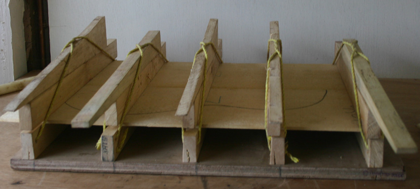

Hello Guys
I use a variation of this, on this version the strings with the bottom runners are fixed to a board.

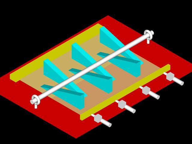

I have a 22” wide x 30” long 5/8 ply board with non stick tape down where the center seam will be and a 1" eye bolt at opposite end of the seam. There are 4 screw clamps on one side attached to a push board that press the planks together, and a clamped stop on the other side . I insert a 7/8 diameter steel round bar in the eye bolts and use 6 wood wedges to compress between the round bar and the seam from alternating directions. Works the same as the rope does but I don't have to wind the rope. I insert a 1/16 thick shim under the seam till the wedges are engaged to hand tight remove the shim and tighten the wedges.

[QUOTE=MichaelP] I have a 22” wide x 30” long 5/8 ply board with non stick tape down where the center seam will be and a 1" eye bolt at opposite end of the seam. There are 4 screw clamps on one side attached to a push board that press the planks together, and a clamped stop on the other side . I insert a 7/8 diameter steel round bar in the eye bolts and use 6 wood wedges to compress between the round bar and the seam from alternating directions. Works the same as the rope does but I don't have to wind the rope. I insert a 1/16 thick shim under the seam till the wedges are engaged to hand tight remove the shim and tighten the wedges.[/QUOTE]
Just to be clearHere is a quick sketch
